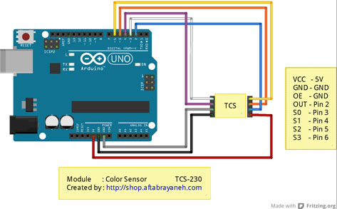

شماتیک مدار:

# Be name Khoda!
# Example code for the TCS230 Color sensor
# Company : AftabRayaneh
# Editor : Elham Rasekh
# Date : 31.08.2013
# Version : 2.0
# s0 -> digital pin 3
# s1 -> digital pin 4
# s2 -> digital pin 5
# s3 -> digital pin 6
# out-> digital pin 2
# OE -> digital pin GND
int tcs_s0 = 3, tcs_s1 = 4, tcs_s2 = 5, tcs_s3 = 6;
int tcs_out = 2;
int flag = 0;
int my_timer = 0;
byte counter = 0;
byte countR = 0, countG = 0, countB = 0;
pinMode(tcs_s0,OUTPUT);
pinMode(tcs_s1,OUTPUT);
pinMode(tcs_s2,OUTPUT);
pinMode(tcs_s3,OUTPUT);
void TCS()
flag=0;
digitalWrite(tcs_s1,HIGH);
digitalWrite(tcs_s0,HIGH);
digitalWrite(tcs_s2,LOW);
digitalWrite(tcs_s3,LOW);
attachInterrupt(0, ISR_INTO, LOW);
timer0_init();
void ISR_INTO()
counter++;
void timer0_init(void)
TCCR2A=0x00;
TCCR2B=0x07; //the clock frequency source 1024 points
TCNT2= 10000; //10 ms overflow again
TIMSK2 = 0x01; //allow interrupt
int i=0;
ISR(TIMER2_OVF_vect)//the timer 2, 10ms interrupt overflow again. Internal overflow interrupt executive function
if (my_timer > 100)
Serial.print("red=");
Serial.println(countR,DEC);
Serial.print("green=");
Serial.println(countG,DEC);
Serial.print("blue=");
Serial.println(countB,DEC);
Serial.println("\n");
my_timer=0;
my_timer++;
TCNT2=100;
flag++;
if(flag==1)
countR=counter;
digitalWrite(tcs_s2,HIGH);
digitalWrite(tcs_s3,HIGH);
else if(flag==2)
countG=counter;
else if(flag==3)
countB=counter;
else if(flag==4)
flag=0;
counter=0;
TCS();
while(1);
