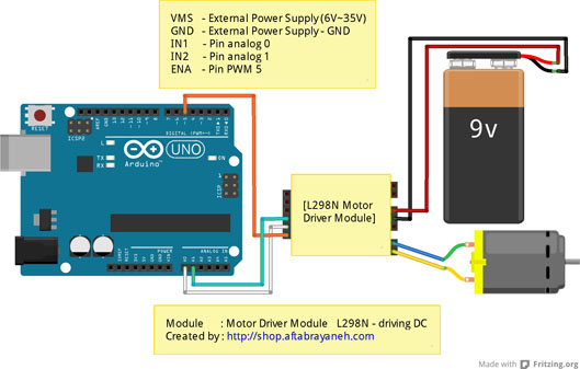

شماتیک مدار جهت راه اندازی موتور DC:
فایل پیوست 212
مثال آردوینو جهت راه اندازی موتور DC:
# Be name Khoda!
# Example code for L298N Motor Driver Module to driving dc
# Company : AftabRayaneh
# Editor : mohammad omidvar -max
# Date : 05.10.2013
# Version : 1.0
# Connect the pins as follow:
in1 -> Pin analog 0
in2 -> Pin analog 1
enA -> Pin pwm 5
//motor pins
int motor1A=A0;
int motor1B=A1;
int en1=5;
int motorSpeed = 250;
void setup(){
pinMode(motor1A, OUTPUT);
pinMode(motor1B, OUTPUT);
pinMode(en1, OUTPUT);
Go();
delay(5000);
Stop();
delay(5000);
void Stop()
{ //to stopping the motor:
//set both of pins A AND B to the same value (HIGH or LOW)
// or set en to 0 -> analogWrite(en1,0);
digitalWrite(motor1A,LOW);
digitalWrite(motor1B,LOW);
void Go()
digitalWrite(motor1A,HIGH);
analogWrite(en1,motorSpeed);
