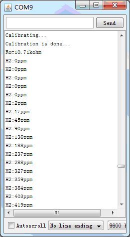

Serial.begin(9600); //UART setup, baudrate = 9600bps
Serial.print("Calibrating...\n");
Ro = MQCalibration(MQ_PIN); //Calibrating the sensor. Please make sure the sensor is in clean air
//when you perform the calibration
Serial.print("Calibration is done...\n");
Serial.print("Ro=");
Serial.print(Ro);
Serial.print("kohm");
Serial.print("\n");
Serial.print("H2:");
Serial.print(MQGetGasPercentage(MQRead(MQ_PIN)/Ro,GAS_H2) );
Serial.print( "ppm" );
Serial.print("\n");
