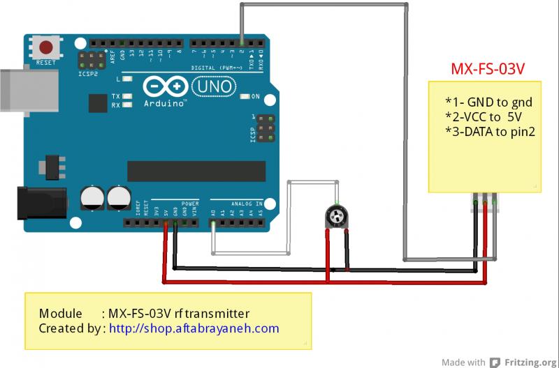

مشخصات فرستنده mx-fs-03v:
 برد فرستنده : 20 تا 200 متر
 ولتاژ تغذيه : 3.5 تا 12 ولت
 سرعت انتقال اطلاعات : 4kB/s
 توان فرستنده: 10mw
 فركانس مدولاتور:315Mhz
فایل پیوست 271

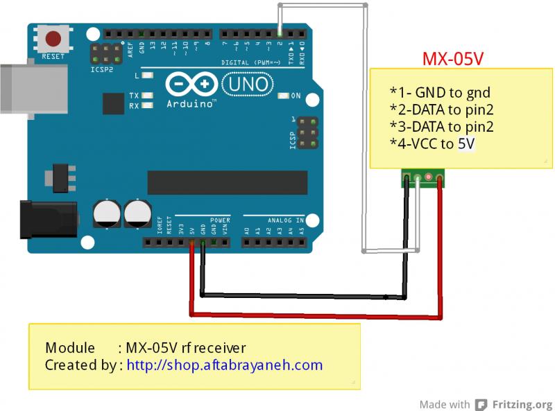

مشخصات گيرندهmx-05v:
 ولتاژ تغذيه : 5 ولت
 حساسيت گيرنده:105db-
 فركانس اسيلاتور:315Mhz
فایل پیوست 272
فایل پیوست 273

در برنامه زير مقدار آنالوگ خوانده شده از ورودي A0 از طريق ماژول فرستنده ارسال ميشود.
 # Example code for MX-FS-03V RF TRANSMITTER
 # Company    : AftabRayaneh
 # Website    : http://shop.aftabrayaneh.com
 # Editor     : mohammad omidvar - max
 # Date       : 19.10.2013
 # Version    : 1.0
Tx MODULE CONNECTIONS:
PIN  DESCRIPTION      ARDUINO PIN
1    GND              GND
2    VCC (3.5-12V)    VCC
3    TX DATA          D2
/*Include the VirtualWire library */
#include <VirtualWire.h>
/* Digital IO pin that will be used for sending data to the transmitter */
const int TX_DIO_Pin = 2;
  pinMode(13, OUTPUT);
  /* Initialises the DIO pin used to send data to the Tx module */
  vw_set_tx_pin(TX_DIO_Pin);
  /* Set the transmit logic level (LOW = transmit for this
     version of module)*/
  vw_set_ptt_inverted(true);
  /* Transmit at 2000 bits per second */
  vw_setup(2000);    // Bits per sec
/* Main program */
  /* Temporarily holds the value read from analogue input A0 */
  unsigned int Data;
  /* The transmit buffer that will hold the data to be
     transmitted. */
  byte TxBuffer[2];
  /* Read the analogue input A0... */
  Data = analogRead(A0);
  /* ...and store it as high and low bytes in the transmit
     buffer */
  TxBuffer[0] = Data >> 8;
  TxBuffer[1] = Data;
  /* Turn on the LED on pin 13 to indicate that we are about
    to transmit data */
  digitalWrite(13, HIGH);
  /* Send the data (2 bytes) */
  vw_send((byte *)TxBuffer, 2);
  /* Wait until the data has been sent */
  vw_wait_tx();
  /* Turn off the LED on pin 13 to indicate that we have
     now sent the data */
  digitalWrite(13, LOW);
  /* Do nothing for a second. Lower this delay to send
     data quicker */
  delay(1000);

Rx MODULE CONNECTIONS:
1    GND              GND
2    RX DATA          D2
3    RX DATA          N/A
4    VCC (5V)         VCC
/* Digital IO pin that will be used for receiving data from the receiver */
const int RX_DIO_Pin = 2;
    /* Initialises the DIO pin used to receive data from the Rx module */
    vw_set_rx_pin(RX_DIO_Pin);
    /* Receive at 2000 bits per second */
    vw_setup(2000);
    /* Enable the receiver */
    vw_rx_start();
/* Main program */
  /* Set the receive buffer size to 2 bytes */
  uint8_t Buffer_Size = 2;
  /* Holds the recived data */
  unsigned int Data;
  /* The receive buffer */
  uint8_t RxBuffer[Buffer_Size];
    /* Has a message been received? */
    if (vw_get_message(RxBuffer, &Buffer_Size)) // Non-blocking
        /* If so, then turn on the LED connected to DIO 13
           to indicate this */
        /* Store the received high and low byte data */
        Data = RxBuffer[0] << 8 | RxBuffer[1];
        /* Output this data to the UART */
   Serial.print("Analogue pin A0: ");
        Serial.println(Data);
        /* Turn off the LED on pin 13 to indicate that the
           data has now been received */
