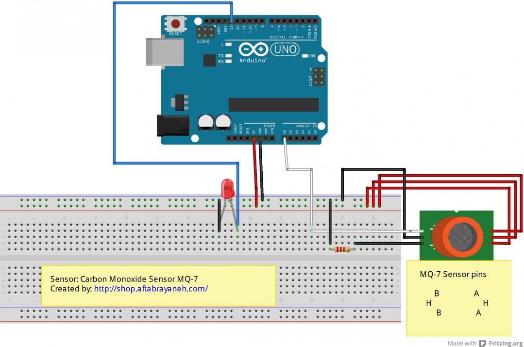

در این مثال تشخیص گاز CO توسط سنسور MQ-7 متصل به آردوینو منجر به روشن شدن LED پین 13 می شود.
فایل پیوست 567
// These constants won't change. They're used to give names
// to the pins used:
const int analogInPin = A0; // Analog input pin that the potentiometer is attached to
const int ledPin = 13; // LED connected to digital pin 13
int sensorValue = 0; // value read from the sensor
// initialize serial communications at 9600 bps:
pinMode(ledPin, OUTPUT); // sets the digital pin as output
// read the analog in value:
sensorValue = analogRead(analogInPin);
// determine alarm status
if (sensorValue >= 750)
digitalWrite(ledPin, HIGH); // sets the LED on
else
digitalWrite(ledPin, LOW); // sets the LED off
// print the results to the serial monitor:
Serial.print("sensor = " );
Serial.println(sensorValue);
// wait 10 milliseconds before the next loop
// for the analog-to-digital converter to settle
// after the last reading:
delay(10);
