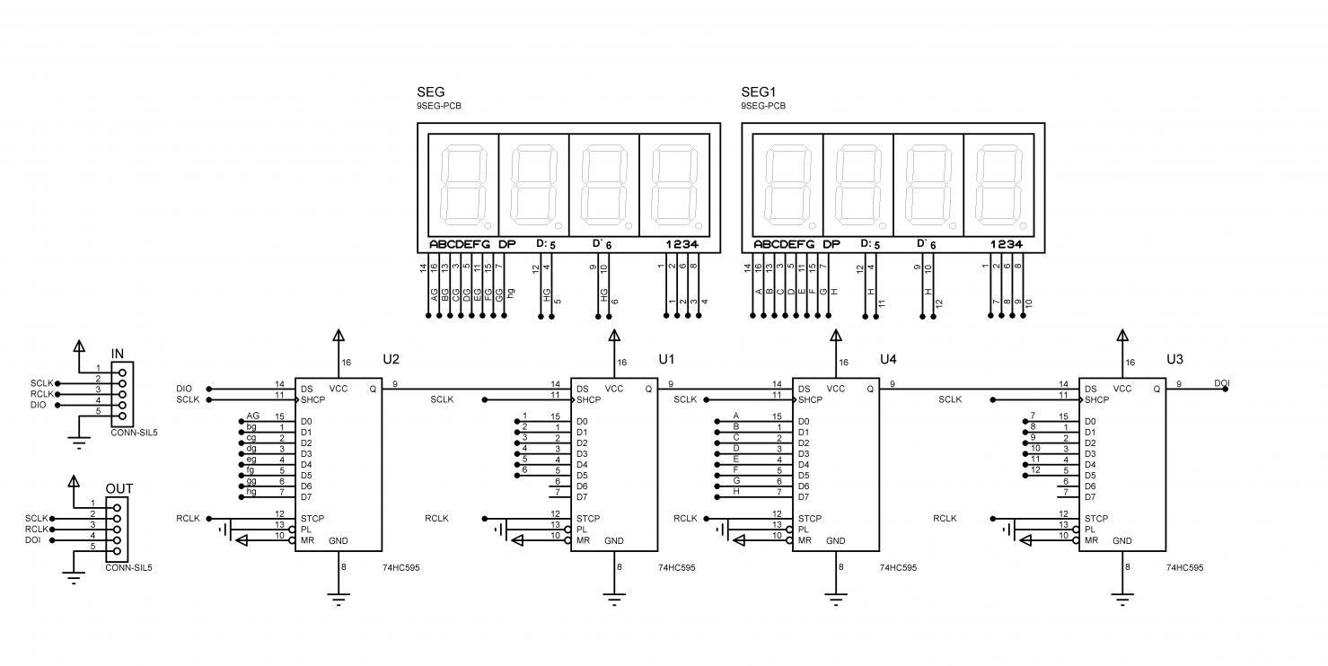

نقل قول:
			//in the name of allah
//pin connected to st_cp of 74hc595
int latchpin = 8;
//pin connected to sh_cp of 74hc595
int clockpin = 12;
////pin connected to ds of 74hc595
int datapin = 11;
int num[10]={0x3f,0x06,0x5b,0x4f,0x66,0x6d,0x7d,0x07,0x7f,0x6  f};
  //set pins to output so you can control the shift register
  pinmode(latchpin, output);
  pinmode(clockpin, output);
  pinmode(datapin, output);
    for(int i = 0; i < 10; i++)
      for(int j = 0; j <= 20; j++)
    digitalwrite(latchpin, low);
    shiftout(datapin, clockpin, msbfirst, 254);
    shiftout(datapin, clockpin, msbfirst, num[i]);
    shiftout(datapin, clockpin, msbfirst, ~254);
    shiftout(datapin, clockpin, msbfirst, ~num[2]);
    digitalwrite(latchpin, high);
    delay(4);
    shiftout(datapin, clockpin, msbfirst, 253);
    shiftout(datapin, clockpin, msbfirst, num[3]);
    shiftout(datapin, clockpin, msbfirst, ~253);
    shiftout(datapin, clockpin, msbfirst, ~num[i]);
    delay(4);
    shiftout(datapin, clockpin, msbfirst, 251);
    shiftout(datapin, clockpin, msbfirst, num[5]);
    shiftout(datapin, clockpin, msbfirst, ~251);
    shiftout(datapin, clockpin, msbfirst, ~num[6]);
    delay(4);
    shiftout(datapin, clockpin, msbfirst, 247);
    shiftout(datapin, clockpin, msbfirst, num[9-i]);
    shiftout(datapin, clockpin, msbfirst, ~247);
    shiftout(datapin, clockpin, msbfirst, ~num[9]);
    delay(4);
