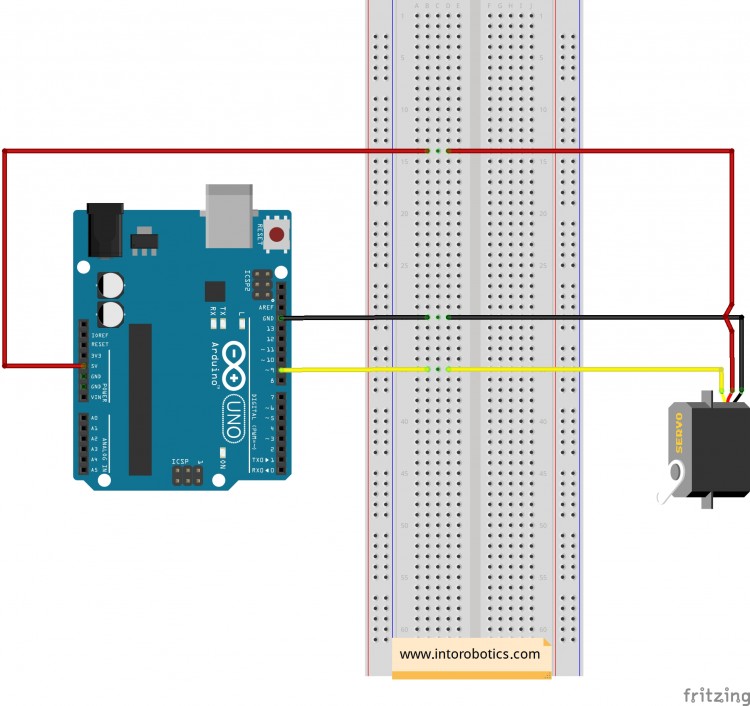

موتور میکرو سروو H512 Tower Pro SG90
نمونه کد آردوینو با کتابخانه سروو :
#include servo.h //add '<' and '>' before and after servo.h
int servoPin = 9;
Servo servo;
int servoAngle = 0; // servo position in degrees
servo.attach(servoPin);
//control the servo's direction and the position of the motor
servo.write(45); // Turn SG90 servo Left to 45 degrees
delay(1000); // Wait 1 second
servo.write(90); // Turn SG90 servo back to 90 degrees (center position)
servo.write(135); // Turn SG90 servo Right to 135 degrees
delay(1000);
//end control the servo's direction and the position of the motor
//control the servo's speed
//if you change the delay value (from example change 50 to 10), the speed of the servo changes
for(servoAngle = 0; servoAngle < 180; servoAngle++) //move the micro servo from 0 degrees to 180 degrees
servo.write(servoAngle);
delay(50);
for(servoAngle = 180; servoAngle > 0; servoAngle--) //now move back the micro servo from 0 degrees to 180 degrees
delay(10);
//end control the servo's speed
