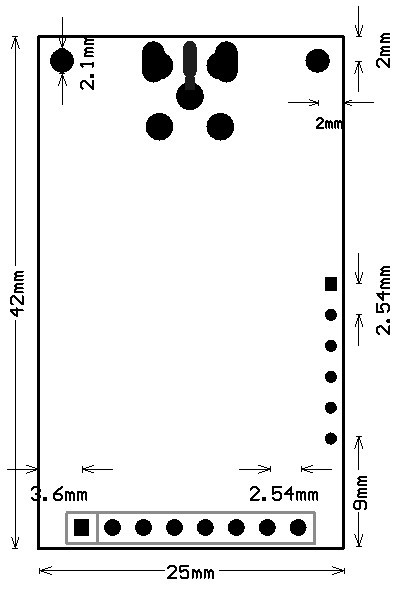

1.2 Dimension
Note: If you need to press the module size PCB backplane design, the company can provide module package library files

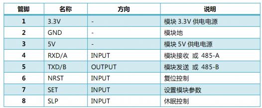

1.3 Pin Definition
Table 1 WSN-02 pin definition table
Note: Pin 1 is the module 3.3V / 3V power input / output ports, users can directly through the pin to the module power supply (pin 3 must be left open at this time); pin 3 to 5V power input module, when the client through the When the pin to the module power output pin a 3.3V / 3V supply.

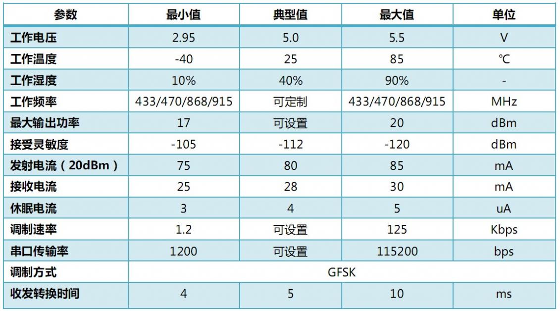

1.4 Technical Parameters
Table 2 Performance Parameters
2 Features
1) Working frequency: 433/470/868 / 915MHz, users can customize
2) GFSK modulation mode, half-duplex communications, air / receiving conversion, connect, control auto-complete
3) receive sensitivity up -120dBm, transmission distance 1000 - 2000 m
4) receive operating current <30mA, Sleep Current <5uA
5) communication protocol conversion and RF transceiver is switched automatically, easy to use
6) serial rate 1200/2400/4800/9600/19200/38400/57600/115200 can be configured via software
7) Wireless rate 1200/2400/4800/9600/19200/38400/57600/115200 available through software configuration
8) Wide voltage range: 2.95V - 5.5V, 5V and 3.3V supports two power supply
9) There are three kinds of interface options are available: TTL level interface, RS232 level interface, RS485 level interface
10) emission current is less than 80mA, the transmit power of up to 20dB, the user can configure the software
11) 256 working channel (recommended 1-64 channels), the user can configure the software
12) remote wireless configuration module parameters for easy on-site installation and construction
