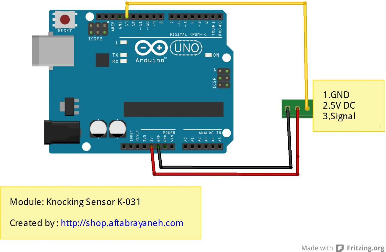

کد بالا جواب نمیده
برای جواب گرفتن کافیه به صورت نرم افزاری pullup کنیم
کد:int led = 13 ;//define led pin int sensor = 10; //sensor pin int val; //define numeric variable selection void setup () { pinmode (led, output); // define led as output pinmode (sensor, input_pullup); // define sensor as input } void loop () { val = digitalread (sensor) ;// sensor and put it into election digitalwrite(led,low); if (val == low) // when the sensor detects a signal, the led flashes { digitalwrite (led, high); delay(100); } }
