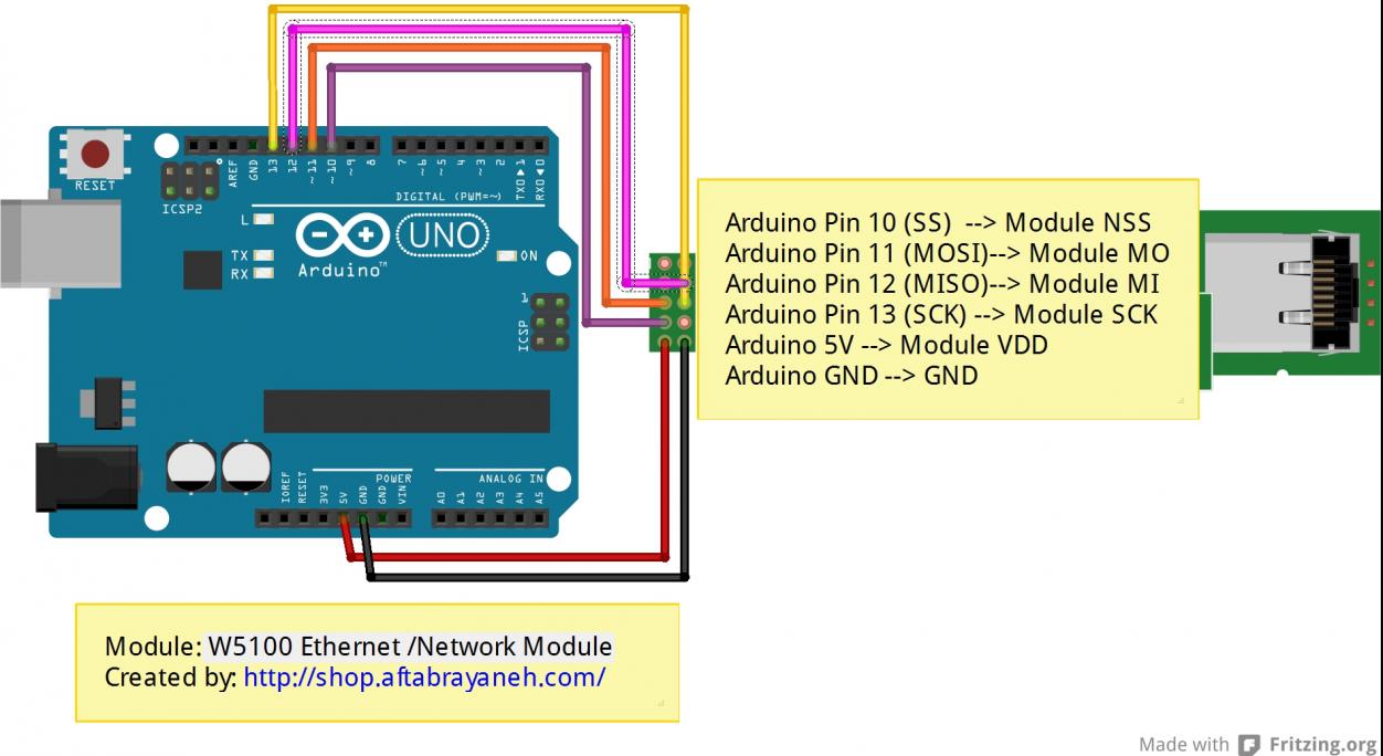

    این مثال نشان می دهد که چگونه می توان با استفاده از ماژول شبکه W5100 و آردوینو نتیجه جستجوی عبارت "Arduino" در گوگل را در Serial Monitor نمایش داد.
نام: W5100 Ethernet-Network Module_fritzing_bb.jpg
مشاهده: 257
حجم: 92.1 کیلو بایت
    #include <SPI.h> #include <Ethernet.h> // Enter a MAC address for your controller below. // Newer Ethernet shields have a MAC address printed on a sticker on the shield byte mac[] = { 0xDE, 0xAD, 0xBE, 0xEF, 0xFE, 0xED }; // if you don't want to use DNS (and reduce your sketch size) // use the numeric IP instead of the name for the server: //IPAddress server(74,125,232,128); // numeric IP for Google (no DNS) char server[] = "www.google.com"; // name address for Google (using DNS) // Set the static IP address to use if the DHCP fails to assign IPAddress ip(192,168,0,177); // Initialize the Ethernet client library // with the IP address and port of the server // that you want to connect to (port 80 is default for HTTP): EthernetClient client; void setup() { // Open serial communications and wait for port to open: Serial.begin(9600); while (!Serial) { ; // wait for serial port to connect. Needed for Leonardo only } // start the Ethernet connection: if (Ethernet.begin(mac) == 0) { Serial.println("Failed to configure Ethernet using DHCP"); // no point in carrying on, so do nothing forevermore: // try to congifure using IP address instead of DHCP: Ethernet.begin(mac, ip); } // give the Ethernet shield a second to initialize: delay(1000); Serial.println("connecting..."); // if you get a connection, report back via serial: if (client.connect(server, 80)) { Serial.println("connected"); // Make a HTTP request: client.println("GET /search?q=arduino HTTP/1.1"); client.println("Host: www.google.com"); client.println("Connection: close"); client.println(); } else { // kf you didn't get a connection to the server: Serial.println("connection failed"); } } void loop() { // if there are incoming bytes available // from the server, read them and print them: if (client.available()) { char c = client.read(); Serial.print(c); } // if the server's disconnected, stop the client: if (!client.connected()) { Serial.println(); Serial.println("disconnecting."); client.stop(); // do nothing forevermore: while(true); } }
