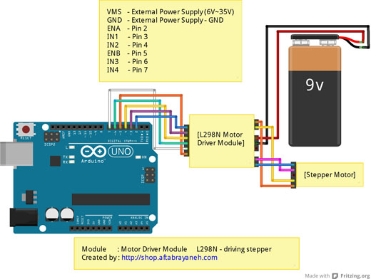

    شماتیک مدار جهت راه اندازی stepper:
نام: L298N_stepper.jpg
مشاهده: 220
حجم: 63.6 کیلو بایت
    مثال آردوینو جهت راه اندازی stepper:
     # Be name Khoda!
     # Example code for L298N Motor Driver Module to driving stepper
     # Company    : AftabRayaneh
     # Editor     : Reza Najafi
     # Date       : 09.09.2013
     # Version    : 1.0
    int ENA=2;//connected to Arduino's port 2
    int IN1=3;//connected to Arduino's port 3
    int IN2=4;//connected to Arduino's port 4
    int ENB=5;//connected to Arduino's port 5
    int IN3=6;//connected to Arduino's port 6
    int IN4=7;//connected to Arduino's port 7
    int _step = 0;
    boolean dir = false; //gre
     pinMode(ENA,OUTPUT);
     pinMode(ENB,OUTPUT);
     pinMode(IN1,OUTPUT);
     pinMode(IN2,OUTPUT);
     pinMode(IN3,OUTPUT);
     pinMode(IN4,OUTPUT);
     digitalWrite(ENA,HIGH);//enable motorA
     digitalWrite(ENB,HIGH);//enable motorB
      switch(_step){
      case 0:
        digitalWrite(IN1, LOW);
        digitalWrite(IN2, LOW);
        digitalWrite(IN3, LOW);
        digitalWrite(IN4, HIGH);
        break;
      case 1:
        digitalWrite(IN3, HIGH);
        break;
      case 2:
        digitalWrite(IN4, LOW);
        break;
      case 3:
        digitalWrite(IN2, HIGH);
        break;
      case 4:
        break;
      case 5:
        digitalWrite(IN1, HIGH);
        break;
      case 6:
        break;
      case 7:
        break;
      default:
        break;
      if(dir){
        _step++;
      else{
        _step--;
      if(_step>7){
        _step=0;
      if(_step<0){
        _step=7;
      delay(10);
    توجه: جهت راه اندازی موتور در جهت عکس، کافیست مقدار dir را برابر true قرار دهید.
