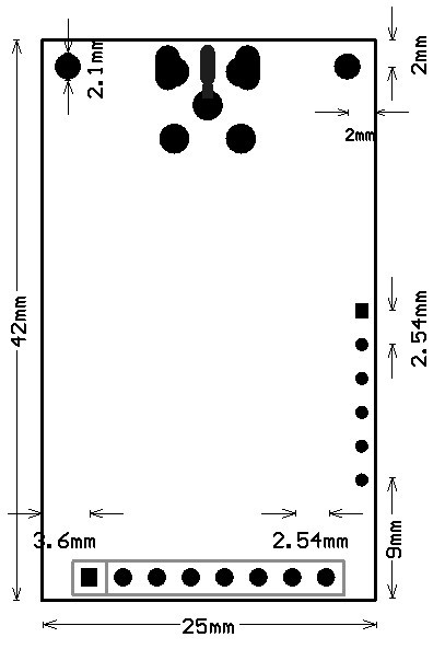

    1.1 Appearance
    1.2 Dimension
    Note: If you need to press the module size PCB backplane design, the company can provide module package library files

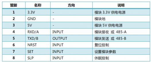

    1.3 Pin Definition
    Table 1 WSN-02 pin definition table
    Note: Pin 1 is the module 3.3V / 3V power input / output ports, users can directly through the pin to the module power supply (pin 3 must be left open at this time); pin 3 to 5V power input module, when the client through the When the pin to the module power output pin a 3.3V / 3V supply.
