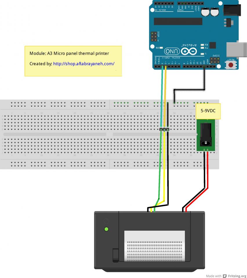

    در این مثال پرینتر از طریق ارتباط سریال با آردوینو کلمه "Hello" را چاپ می کند.
نام: Thermal printer_bb.jpg
مشاهده: 996
حجم: 84.0 کیلو بایت
    #include <SoftwareSerial.h> #include <Thermal.h> int printer_RX_Pin = 2; int printer_TX_Pin = 3; Thermal printer(printer_RX_Pin, printer_TX_Pin, 19200); void setup(){ //////////////////////////////////////////////////////////////////// //Following are in setup, but do not need to be. Use them anywhere. //Just here so they do not just keep printing over and over //Printer will ignore commands during printing, so use delay(3000) //after prints to ensure it see everything you want to print. //SOME FUNCTIONS WILL FEED A LINE WHEN CALLED TO SOLIDIFY SETTING //////////////////////////////////////////////////////////////////// printer.justify('R'); //sets text justification (right, left, center) accepts 'L', 'C', 'R' printer.setSize('L'); // set type size, accepts 'S', 'M', 'L' printer.println("hello"); //print line printer.setSize('M'); // set type size, accepts 'S', 'M', 'L' printer.println("hello"); //print line printer.setSize('S'); // set type size, accepts 'S', 'M', 'L' printer.println("hello"); //print line printer.feed(); //advance one line printer.feed(); //advance one line //printer.setHeatTime(80); // 80 is default from page 23 of datasheet. Controls speed of printing and darkness //printer.setHeatInterval(2); // 2 is default from page 23 of datasheet. Controls speed of printing and darkness //printer.setPrintDensity(15); // Not sure what the defaut is. Testing shows the max helps darken text. From page 23. //printer.setPrintBreakTime(15); // Not sure what the defaut is. Testing shows the max helps darken text. From page 23. //printer.print("hello"); //add text to print line without printing it. Call println to print.//printer.print(1234); //printer.println("hello"); //print line//printer.println(1234); //printer.printBarcode("123456789123"); //print simple bar code - up to 12 characters long//printer.printFancyBarCode("WWW.BILDR.ORG"); // print fancy barcode. Cap latters and some symbols //printer.printFancyBarcode("WWW.BILDR.ORG"); // print fancy barcode. Cap latters and some symbols //printer.setBarcodeHeight(50); // set barcode px height: 0-255 //printer.boldOn(); // Turn bold on//printer.boldOff(); //Rurn bold off //printer.doubleHeightOn(); // sets type to print double hight//printer.doubleHeightOff(); //Turn off double hight printing //printer.inverseOn(); //set to print white on black//printer.inverseOff(); //set to print black on white (default) //printer.sleep(); //Tell printer to sleep. MUST call wake before printing again, even if reset//printer.wake(); //Wake //printer. //printer.wake(); //printer.setSize('L'); // set type size, accepts 'S', 'M', 'L' //printer.feed(); //advance one line //printer.tab(); //Tabs text over 8 spaces //printer.justify('R'); //sets text justification (left, center, right) accepts 'L', 'C', 'R' //printer.setDefault(); //set printer to defaults. ****WILL FEED SEVERAL LINES WHEN CALLED*** } void loop(){ }
    اگر پرينتر را با استفاده از بوردهاي Arduino راه اندازي ميكنيد حتما بايد تغذيه پرينتر را بصورت جداگانه و از منبع تغذيه خارجي فراهم كنيد.
    زيرا جريان كاري پرينتر بالاتر از جريان قابل تامين توسط كابل و پورت USB است. براي تغذيه اين پرينتر يك آداپتور 5 ولت بهترين انتخاب خواهد بود.
